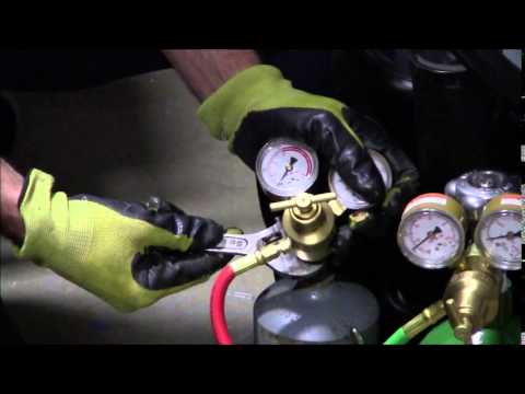

  3. Attach the regulators to their respective gas (The red hose is acetylene and the green is oxygen).  Each is sized as shown above to the correct gas bottle to avoid errors. Screw it on by hand at first and then tighten with a tool. First, start with the oxygen regulator and then move on to the oxyacetylene tank.
    Attaching the Fuel Pressure Regulator to the Oxygen Tank
    Tightening the Regulator Valve to the Oxygen Tank By Hand and Then With a Smooth Jaw Adjustable Wrench. Make Sure the Gauges are Level When Tightening – Make Fairly Tight

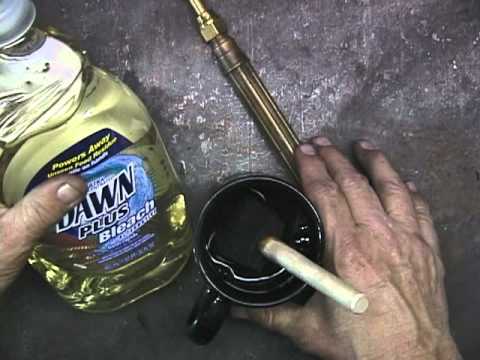

  • After an hour re-check the regulators. The needle will either be in the same place showing there are no leaks, or the needle dropped down a bit (showing a slow leak) or the needle drops down a larger amount, showing a larger leak.
  • Next, if you find you have a leak, you need to determine where the leak is. Use some dish washing liquid in a bit of water and use it to go over all of the fittings. If you brush some on and see bubbles then you have a lead. If you see bubbles tighten the screw.
