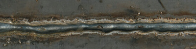

2. Slag Inclusions
weld defect inclusions
Slag inclusions
© weldguru.com – Image usage rights
Slag inclusions are internal weld defects where impurities become trapped inside a weld, significantly compromising its strength. While they commonly occur in flux-related processes, MIG and TIG welding aren’t immune either.
Understanding how to prevent these inclusions is essential for any welder.
  • Flux-Related: Slag often forms in brazing, stick, flux-cored, and submerged arc welding. The slag needs to rise to the molten pool’s surface rather than getting trapped in the bead.
  • MIG and TIG Welding: Contaminants such as bits of rust and even tungsten can lead to inclusions.
How to Prevent Slag Inclusions
  • Clean the base metal thoroughly before welding.
  • Avoid low amperage settings to prevent the weld pool from cooling too quickly.
  • Maintain an appropriate torch speed to keep the welding and slag pools separate.
  • Use the correct torch angle to promote a clean weld.
  • Remove any slag from previous welds between passes.

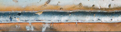

3. Lack of Fusion
weld defect lack of fusion
Lack of fusion
A lack of fusion is an internal weld defect that occurs when the filler material doesn’t bond well with the base metal, leading to structural weaknesses like voids and gaps. Given the impact on structural integrity, understanding how to prevent this issue is vital for quality welding.
Understanding the Issue
A poorly bonded joint can result from improper technique, incorrect electrode size, or the wrong electrode alloy.
The weld’s structural integrity is compromised when there are gaps, voids, or poor adhesion between the filler material and the base metal.
How to Prevent Lack of Fusion
  • Start by thoroughly cleaning the base metal to remove any impurities.
  • Choose the correct electrode size and alloy to match the base metal.
  • Maintain a steady torch speed; moving too fast can lead to gaps.
  • Keep the arc length appropriate for the job at hand.
  • Ensure your amperage setting is sufficient to create a strong bond.

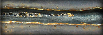

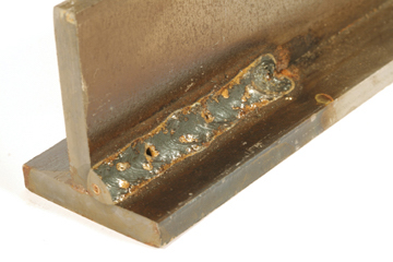

4. Porosity
weld defect porosity
Porosity
Porosity in a weld, commonly known as “wormhole weld,” is an external weld defect that occurs when gas bubbles are trapped inside the weld bead, weakening the joint. These bubbles make the weld resemble a sponge, posing significant risks to the work’s durability.
Understanding Porosity
As you weld, gases like steam, hydrogen, and carbon dioxide typically bubble out of the molten bead. However, when these gases get trapped, they can seriously weaken the weld.
How to Avoid Porous Welds
  • Start by cleaning and preparing the base metal; ensure it’s dry.
  • Set your shielding gas flow correctly to avoid low or high levels that can trap gases.
  • Keep the amperage appropriate; excessively high settings can exacerbate the problem.
  • Use the right electrode alloy suited for your welding task.
  • If your electrode has a coating, ensure it’s undamaged.
  • Maintain a slow and steady torch speed to allow the molten puddle to form, giving gases time to escape.
  • Use a short arc length.
  • Use low hydrogen electrodes when possible.

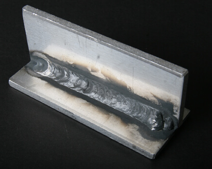

9. Excess Reinforcement
weld defect excess reinforcement 2
Excess reinforcement
Excess reinforcement is an external weld defect that occurs when there’s too much filler material in the weld, commonly referred to as a “high” crown.
Most project specifications and codes limit the height of such reinforcement, usually capping it at no more than 3 mm (⅛”) above the parent metal.
Variations of Excess Reinforcement
  • Excess Penetration: When the filler material protrudes out from the bottom of the joint.
  • Steep-Sided Beads: Caused by insufficient flux coating on the feed wire or low voltage settings.
  • Mountain Range Reinforcement: This uneven, jagged form of excess reinforcement can result from excessive flux on the feed wire or inconsistent travel speed.
How to Prevent Excess Reinforcement
  • Maintain an appropriate torch speed. Moving too slowly will lead to excessive filler, while too fast can result in an erratic bead.
  • Correctly set your amperage to avoid excessive heat.
  • Ensure your voltage is neither too low nor too high.
  • Properly align the workpieces to avoid large gaps.
  • Push the weld rather than dragging it to distribute the filler material more evenly.
