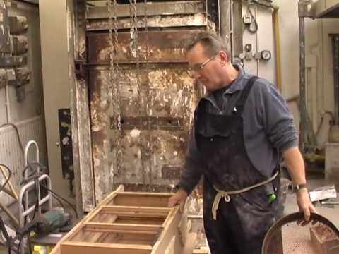

Molding and Box Materials
A multi-part molding box (known as a casting flask, sometimes referred to as the cope and drag) is prepared to receive the pattern.
Molding boxes are made in segments that may be latched to each other and to end closures.
For a simple object—flat on one side—the lower portion of the box, closed at the bottom, will be filled with prepared casting sand or green sand—a slightly moist mixture of sand and clay.
The sand is packed in through a vibratory process called ramming and, in this case, periodically screeded level. The surface of the sand may then be stabilized with a sizing compound. The pattern is placed on the sand and another molding box segment is added. Additional sand is rammed over and around the pattern.
Finally a cover is placed on the box and it is turned and unlatched, so that the halves of the mold may be parted and the pattern with its sprue and vent patterns removed.
Additional sizing may be added and any defects introduced by the removal of the pattern are corrected.
The box is closed again. This forms a “green” mold which must be dried to receive the hot metal.
