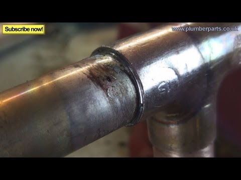

  • Gas: also know as a blowtorch, is used for projects such as copper pipes or iron. It can be used for every type of project including electronics. When soldering copper pipes we like to use MAPP gas torch, which comes in a yellow cylinder.
Gas Soldering Torch
Gas Soldering Torch
Mapp Gas Self Igniting Soldering Torch used for Copper Pipe Soldering

Soft solder joints may be made by using gas flames, wiping, sweating the joints, or by dipping in solder baths.
Dipping is particularly applicable to the repair of radiator cores.
Electrical connections and sheet metal are soldered with a soldering iron or gun.
Wiping is a method used for joining lead pipe and also the lead jacket of underground and other lead-covered cables.
Sweated joints may be made by applying a mixture of solder powder and paste flux to the joints.
Then heat the part until this solder mixture liquifies and flows into the joints, or tin mating surfaces of members to be joined, and apply heat to complete the joint.
