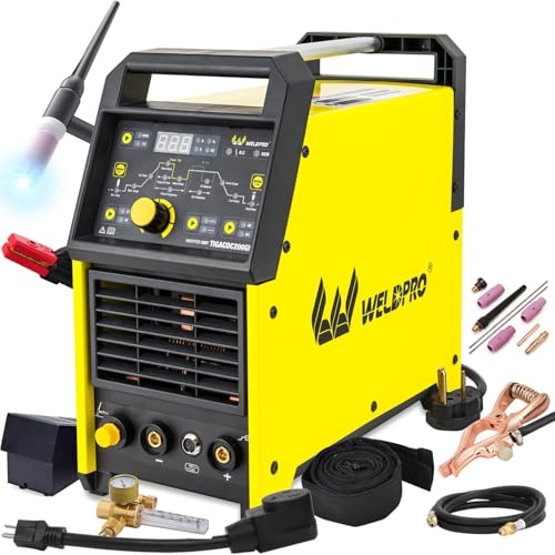

7. Weldpro Digital TIG 200GD AC/DC TIG Welder
  • 120/240 volt dual power
  • 2T/4T hold switch
  • Wide 10 to 200 amp range
  • Comes with a foot pedal
  • Angled control panel
  • High frequency pilot arc
  • 200 hertz pulse modulation
  • Preflow/postflow for cleaner welds
  • AC and DC welding
  • AC balance for cleaning oxidation
  • Pedal isn’t high quality
  • Reports of non-working current knob
The Weldpro Digital TIG 200GD TIG Welder is an easy to use TIG welder that runs on dual 120/240 volt input power and has both DC and AC TIG with 200 hertz pulse width modulation for variable bead width. The adjustable AC balance goes from 30 to 70 percent and cleans aluminum oxidation while delivering good weld penetration.
The Weldpro Digital is equipped with a CK17 torch with a flex head that uses standard American parts. There are quite a few complaints about quality issues with the heat control pedal. The Weldpro Digital TIG 200GD features a 2T/4T switch that works as a torch lock. This lets you make long bead runs without needing to hold the torch trigger down while MIG welding.
These TIG welders offer a wide 5 to 200 amp TIG AC range when using a 240 volt power source. There’s up to 140 amps on 120 input. The AHP AlphaTIG 200X includes a high-frequency no-touch arc start, keeping contamination away from the tungsten electrode.
The Weldpro Digital TIG 200GD has a digital display and it’s backed with a 2-year warranty and includes MIG and TIG torches, a regulator and an electrode clamp.

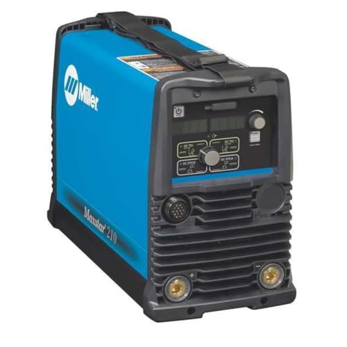

8. Miller Electric Maxstar STR TIG Welder
  • 1- and 3-phase input voltage
  • Uses any power source from 110 to 480 volts
  • Memory card data port
  • Updatable software
  • Sleep timer powers down idle machine
  • Among the top AC/DC TIG welders in its class
  • High frequency arc starting
  • Settings memory makes it easy to use
  • 10 amp low end welds thin sheet metal
  • 100 percent duty cycle at 175 amps
  • Doesn't include a TIG torch
  • DC processes only
The Miller Electric Maxstar STR 210 TIG Welder with High Frequency lift start is one of the newest additions to the Miller TIG welding lineup, designed for professional DC TIG welders for stainless and mild steel. DC can work for welding aluminum, but it’s a welding process not often done in production environments, because careful cleaning and helium/argon mix add too much expense. The MaxStar can provide the means to do it if called on, however.
The MaxStar has a standby power switch on the front panel to put the machine into sleep state, conserving power when it’s not welding. Miller’s TIG Pro-Set system provides factory presets to get you up and running quickly. The wireless remote means the Miller Maxstar STR210 TIG Welder is easy to use from 300 feet away without having to walk all the way back to where it’s stationed just to make adjustments. This is just one more feature designed for industrial use on this amazing TIG welding machine.
Our top pick, the Miller Electric MaxStar 210 STR is a great value, featuring a wide amperage range with improved low amperage operations, allowing much smoother control when welding sheet metal. A memory card port lets you save settings between machines. Auto-Line multi-voltage input, 100 percent duty cycle at 175 amps and Miller’s 3-year warranty earned the MaxStar 210 our Premium Pick.a
