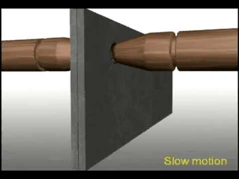

Resistance Welding Video
YouTube video

Heat is generated by the passage of electrical current through a resistance circuit. The force applied before, during, and after the current flow forces the heated parts together so that coalescence will occur. Pressure is required throughout the entire welding cycle to assure a continuous electrical circuit through the work.
Resistance welds are made very quickly; however, each process has its own time cycle.
Resistance welding operations are automatic. The pressure is applied by mechanical, hydraulic, or pneumatic systems. Motion, when it is involved, is applied mechanically. Current control is completely automatic once the welding operator initiates the weld. Resistance welding equipment utilizes programmers for controlling current, time cycles, pressure, and movement. Welding programs for resistance welding can become quite complex. In view of this, quality welds do not depend on welding operator skill but more on the proper set up and adjustment of the equipment and adherence to weld schedules.
This concept of resistance welding is most easily understood by relating it to resistance spot welding. Resistance spot welding, the most popular, is shown in figure 10-77 below. High current at a low voltage flows through the circuit and is in accordance with Ohm’s law.
  • (a) I is the current in amperes, E is the voltage in volts, and R is the resistance of the material in ohms. The total energy is expressed by the formula:
    Energy = I x E x T in which T is the time in seconds during which current flows in the circuit.
  • (b) Combining these two equations gives H (heat energy) = 12 x R x T.
    For practical reasons a factor which relates to heat losses should be included; therefore, the actual resistance welding formula is
    H (heat energy) =I2 x R x T x K
  • (c) In this formula, I = current squared in amperes, R is the resistance of the work in ohms, T is the time of current flow in seconds, and K represents the heat losses through radiation and conduction.
resistance spot welding fig10 77
Resistance Spot Welding Process Diagram – Figure 10-77
The resistive heating process occurs between the two pieces of metal. The current flows across the electrodes and metal, causing the formation of the weld nugget. When the welding current is turned off, the weld cools causing the welding nugget to become solid while joining the two pieces of metal.
Resistance spot welding is used extensively because it is a simple, inexpensive, versatile, and forgiving process.  It has been shown to be adaptable to some degree of feedback control.
