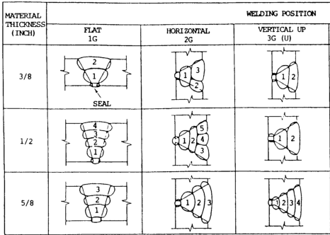

Figure 6-15 is based on weld type and position.
The primary heat zone is the area fused or affected by heat in the first pass or application of weld metal.
The secondary heat zone is the area affected in the second pass and overlaps the primary heat zone.
The portion of base metal that hardens or changes its properties as a result of the welding heat in the primary zone is partly annealed or softened by the welding heat in the secondary zone.
The weld metal in the first layer is also refined in structure by the welding heat of the second layer.
The two heating conditions are important in determining the order or sequence in depositing weld metal in a particular joint design.

Welding procedure schedule of various welds. The nomenclature of the weld, the zones affected by the welding heat when a butt weld is made by more than one pass or layer, and the nomenclature applying to the grooves used in butt welding are shown in figure 6-14. Figure 6-15 is based on weld type and position.
Flat, Horizontal and Flat Weld Position Chart
Vertical Down and Overhead Weld Position Chart for Welds Under 1″
Flat and Horizontal Position for Welds 1″ or Larger
Welding Positions for Materials Over 1 Inch

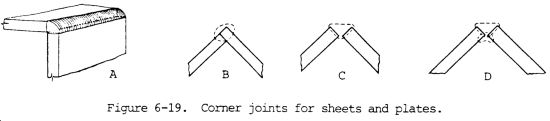

Corner Joint
Corner Joints for Sheets and Plates
Corner Joints Figure 6-19
The common corner joints are classified as flush or closed, half open, and full open. This type of joint is used to join two members located at approximately right angles to each other in the form of an L.
The fillet weld corner joint (view A, fig. 6-19) is used in the construction of boxes, box frames, tanks, and similar fabrications.
The closed corner joint (view B, fig. 6-19) is used on light sheet metal, usually 20 gage or less, and on lighter sheets when high strength is not required at the joint.
In making the joint by oxyacetylene welding, the overlapping edge is melted down, and little or no filler metal is added.
In arc welding, only a very light bead is required to make the joint.
When the closed joint is used for heavy sections, the lapped plate is V beveled or U grooved to permit penetration to root of the joint.
Half open comer joints are suitable for material 12 gage and heavier.
This joint is used when welding can only be performed on one side and when loads will not be severe.
The open corner joint (view C, fig. 6-19) is used on heavier sheets and plates.
The two edges are melted down and filler metal is added to fill up the corner.
This type of joint is the strongest of the corner joints.
Corner joints on heavy plates are welded from both sides as shown in view D, figure 6-19.
The joint is first welded from the outside, then reinforced from the back side with a seal bead.

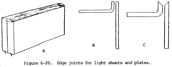

Edge Joints
Edge Joints for Light Sheets and Plates
Edge Joints Figure 6-20
This type of joint is used to join two or more parallel or nearly parallel members.
It is not very strong and is used to join edges of sheet metal, reinforcing plates in flanges of I beams, edges of angles, mufflers, tanks for liquids, housing, etc.
Two parallel plates are joined together as shown in view A, figure 6-20.
On heavy plates, sufficient filler metal is added to fuse or melt each plate edge completely and to reinforce the joint.
b. Light sheets are welded as shown in view B, figure 6-20. No preparation is necessary other than to clean the edges and tack weld them in position.
The edges are fused together so no filler metal is required. The heavy plate joint as shown in view C, figure 6-20, requires that the edges be beveled in order to secure good penetration and fusion of the side walls.
