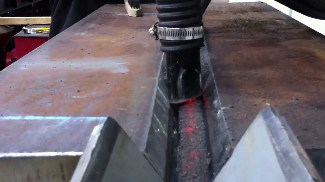

SAW Equipment
Shown: SAW or submerged arc welding equipment completing a weld. The weld starts on the right and moves left. The gray colored powder is flux
For semiautomatic application, a welding gun and cable assembly are used to carry the electrode and current and to provide the flux at the arc.
A small flux hopper is attached to the end of the cable assembly.
The electrode wire is fed through the bottom of this flux hopper through a current pickup tip to the arc.
The flux is fed from the hopper to the welding area by means of gravity.
The amount of flux fed depends on how high the gun is held above the work.
