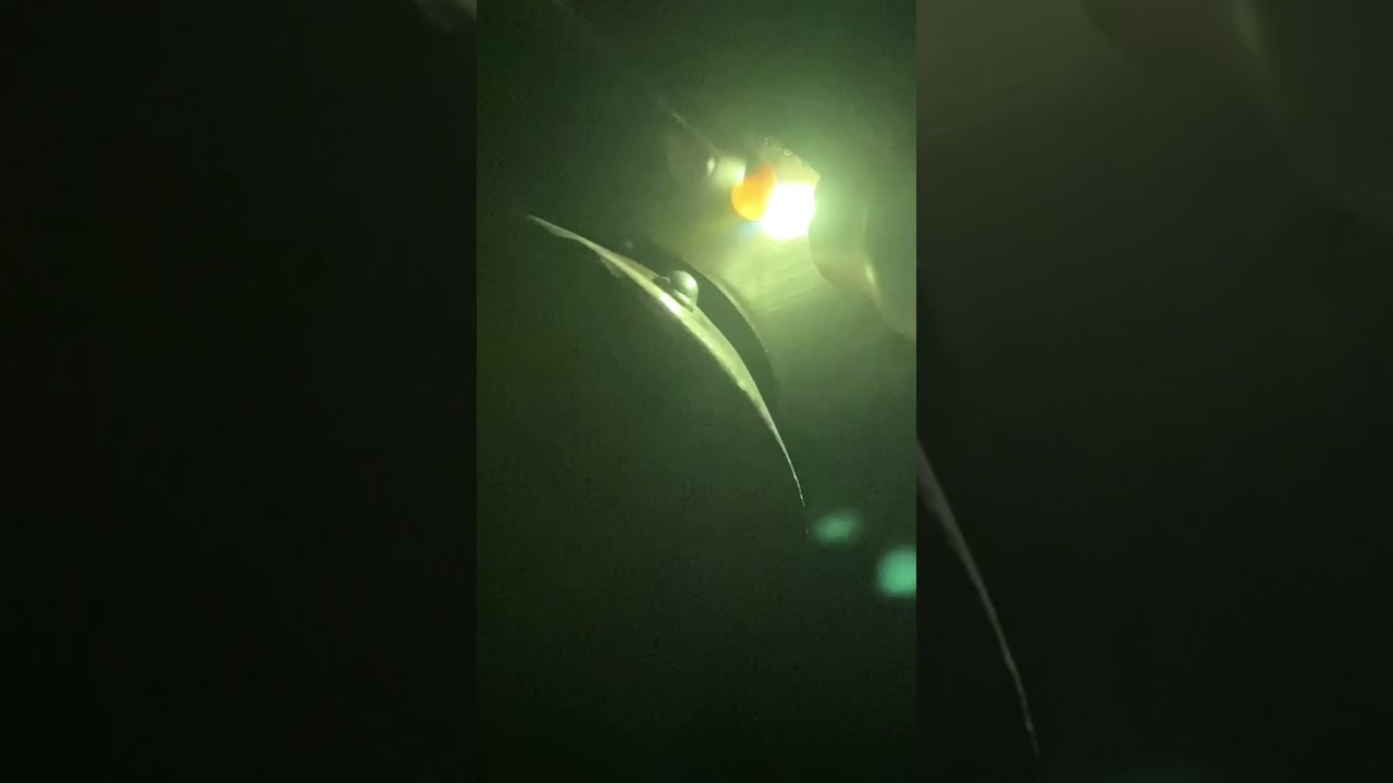

2. Bridge Tack Weld
If the joint design requires a root opening, like pipes often do, it’s necessary to bridge the gap with tacks.
However, this form of tacking requires more skill. It’s easy to apply excess heat, which widens the gap on the opposite side of the joint.
But, one significant point here is that bridge tacks don’t penetrate the root of the joint. You can grind them off after you make the first root pass.
YouTube video
