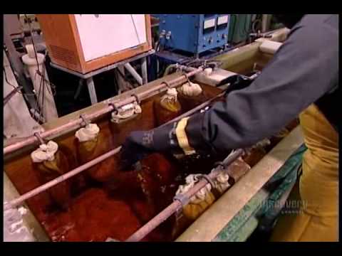

    Hanging part to be electroplated on the copper frame. Copper Wire suspends part from top and continues to bottom creating an electrical circuit through the part to be welded.
    Electroplating Tank
    The electroplating tank is filled with water and chemicals to help conduct electricity. The sides of the tank are lined with bags or balls of the plating metal. The support frame holding the part is connected to a negative terminal of the electrical source. The metal that is to be plated is connected to the positive terminal. A DC current of up to 6 volts dissolves the plating metal which travels through the water, attaching to the negatively charged piece to be plated. The process can take just a few minutes for thin plating to several hours for thick plating.
