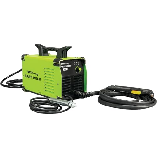

3. Forney Easy Weld 20 P Plasma Cutting Machine
- 120 volts input - plug in anywhere
- 35 percent duty cycle
- 1-year warranty
- 20 amps output power
- Weighs only 21 pounds
- Industrial construction
- Cuts 1/4-inch steel
- Generator friendly
- 13-foot torch connection
- Drag torch cutting
- 120 volts only
- Costly for its power level
The Forney Easy Weld 20P plasma cutter is lightweight and powerful for a 120 volt machine. With a 20 amp power output, it’s able to cut steel up to 1/4-inch thick. At 21 pounds, it’s very portable and quite practical for use around the household, in the workshop and as a jobsite tool for professionals who need to work inside customer homes.
With an industrial build, a 13-foot torch connection and drag cutting arc starts, the Forney Easy Weld 20P provides reliable and professional features that are hard to find in this price range. Forney’s been making welding machines for 90 years now and know what it takes to keep a plasma cutter functioning in the modern industrial setting.
Nothing’s perfect, of course, and in this case you might want something more powerful than this machine if you’re doing any kind of volume fabrication. 1/4-inch is pushing the limit if you’re doing things like fabricating hitches, modifying frames or customizing suspension parts. Forney does have good customer service and offers a 1-year warranty on this high quality plasma cutter.
