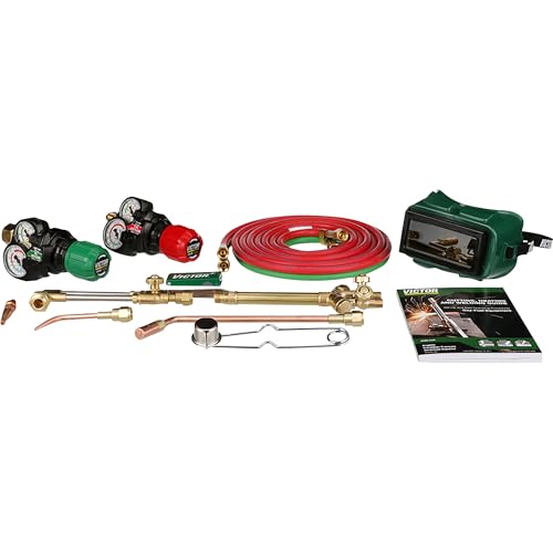

1. Victor Performer EDGE 2.0 Oxy Acetylene Torch Kit
  • Maximum Cutting: 6" (152.4 mm)
  • Maximum Welding: 1/4 in. (6.4 mm)
  • Hose length: 12.5 feet
  • Shade level 5 goggles
  • Built-in flashback arrestors
  • Heating nozzle included
  • Welding nozzle included
  • Complete kit, ready to use
  • Longer hose needed
  • Goggles are very cheap
The Performer EDGE 2.0 is a complete cutting torch kit with goggles and a few extra parts included. The WH100FC welding handle is designed as the medium-duty base for a versatile, full-range cutting and welding system. It’s capable of using all fuels used in oxyfuel operations for cutting, welding, or heating metal. This handle is equipped with built-in flash arrestors and reverse flow check valves for safety.
ESAB also included the CA1350 cutting attachment, performance-matched specifically to the WH100FC welding handle. The Performer EDGE 2.0 Cutting Torch Kit features Victor Traditional threaded assemblies for fast, easy and affordable servicing.
The Victor Performer EDGE 2.0 Cutting Torch Kit can cut up to 1/2-inch steel right out of the box. With available Victor attachments, this torch can cut steel up to 6 inches thick. As delivered, the Performer gives you 1/4-inch welding capability, and optional attachments can weld steel up to 1/4 in. thick.

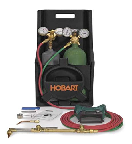

2. Hobart Oxy/Acetylene Tag-A-Long Portable Cutting Torch Kit
  • Maximum Cutting: 3/8"
  • Maximum Welding: 1/8"
  • Includes goggles
  • Highly portable
  • Carrier tote
  • Uses Victor tips
  • Great for quick jobs
  • Tanks are small
  • Short hose
The Hobart Oxy/Acetylene Portable Cutting Torch Kit is the perfect set to go on a farm or ranch truck for quick repair work because it weighs under 32 pounds and its integrated carrier tote lets it fit just about anywhere. These qualities also make it a great choice for the home DIY shop. A 12.5-foot hose is a little short with a full-size setup, but this outfit makes the kit easier to store, carry, and put into action.
Hobart designed the Tag-A-Long to be compatible with Victor torches, meaning parts are easy to get and don’t cost a lot. This torch will cut steel up to ⅜-inch thick with the included #0 cutting tip. Wiha Victor #4, you can easily cut up to ½-inch thick, and with larger tanks, you can use a #5 tip to get up to ¾-inch thick without needing bigger hoses.
The #0 welding tip that comes with the Hobart Tag-A-Long lets you weld metal up to ⅛-inch thick, heavy enough for equipment brackets, angle iron structures, and pipe fencing. A Victor #4 tip would give you welding up to ½-inch thickness.
