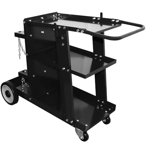

3. Weldpro Multi Function 3 tier Welding Cart
  • 3 tier welding cart
  • 2 tiers for machines & one for accessories
  • Holds up to 125CF Gas Bottle
  • Hold up to 300lbs
  • Assemble was straight forward with good instructions
  • Feels strong and sturdy when built
  • Big handle at the front makes it easy to move around
  • Hooks on both sides for cable storage
  • Swivel front casters feel solid and smooth to move
  • Assembly was a little difficult getting shelve holes to line up
  • Middle shelve is not adjustable without adding your own holes
The 25-pound Metal Man UWC1 Universal welding cart is 32 inches tall and 16 inches wide, with room for a welder up to 18 inches deep. This is a 2-tier design with an angled top shelf. This is another cart that has a reversible handle to improve clearance to handle a wider variety of welders. The six-inch rear wheels are sturdy enough for the rated load, but the front casters should be larger than 2 inch diameter to roll over cords or concrete joints.
One thing to be aware of when using an angled shelf is that a tall-box welder shape will potentially reach into the cylinder area at the rear of the Metal Man UWC1 Universal welding cart. One owner with an AHP AlphaTIG 200x solved this issue by adding a piece of 1/2-inch thick board at the back of the angled tray.
The Metal Man UWC1 Universal welding cart holds a gas bottle up to 7-inch diameter, but its short height means you many want to go with a shorter 90 cubic foot bottle. There are two chains to secure your shielding gas cylinder.
