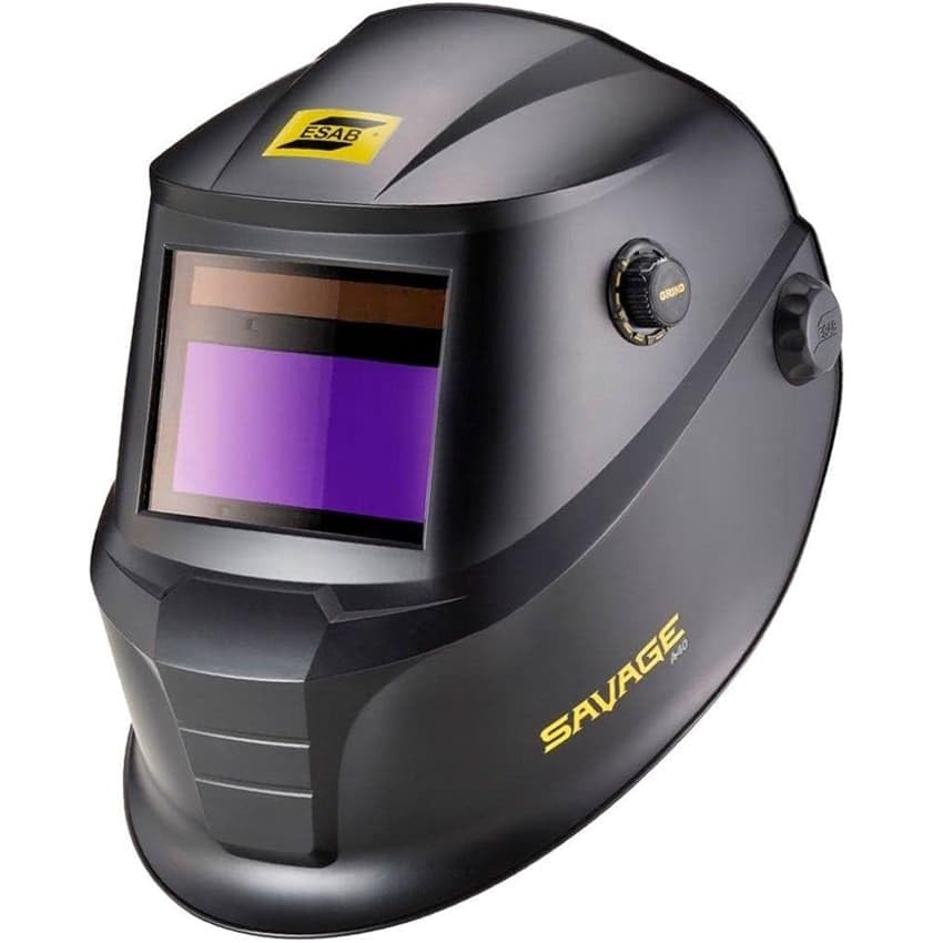

4. ESAB Savage A40 Black Welding Helmet
  • External shade control
  • 4 arc sensors
  • True color technology
  • High tech, lightweight shell
  • 7.7 Square-inch viewport
  • Optical clarity 1/1/1/2
  • Delay and response controls are inside
  • External grind mode button
  • 5 amps TIG sensitivity
  • Solar powered
  • Triggered by LED lighting
  • Doesn’t charge the battery
Another respected helmet in the sub $200 category is the ESAB Savage A40 as it features true color technology, providing real-world colors at an affordable price. The auto-darkening function is sensitive down to 5 amps for DC TIG. Not all auto-darkening helmets will react consistently to low-amperage TIG arcs, especially DC TIG because the arc simply isn’t as bright as those of other processes.
This helmet offers a nice range of features for its class. The ESAB Savage A40 Black Welding Helmet has a reaction time of 0.07 milliseconds and its optical clarity rating is 1/1/1/2. Combined with the 7.7 square inch true color viewport, it’s very easy to see your work and improve your quality. Although it features a lithium battery and solar power, the Savage A40 doesn’t charge the battery.
The ESAB Savage A40 Black Welding Helmet variable delay adjustment lets you decide how long to keep the viewport darkened after you stop welding. One issue mentioned by owners was a tendency for the auto-darkening to triger in bright LED lighting. ESAB credits the design inspiration for this helmet to its radically-styled Sentinel A50, which is a more upscale helmet for professional welders.

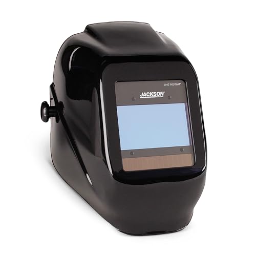

5. Jackson Safety Insight Auto Darkening Welding Helmet - Excellent comfort
  • 4 Arc Sensors
  • 9 square inch viewport
  • Digital controls
  • Lithium batteries
  • Grind mode
  • Industry favorite headgear
  • Outstanding optics
  • Ultra lightweight nylon shell
  • Jackson shells are interchangeable
  • Shade levels 9-13
  • Could be sturdier
  • Not for overhead work
Jackson Safety makes some of the most common welding helmets out there. The Jackson Insight Variable Auto-Darkening Welding Helmet is known for its comfortable HaloX headgear. It’s often transplanted into other brands of helmet. With this headgear and the ultra lightweight nylon shell, the Jackson Insight is well-suited to long work shifts. It’s also reported by owners to be well-balanced on the head.
The Jackson Insight Variable Auto-Darkening Welding Helmet gets a lot of praise for high-quality optics and great auto-darkening performance. The controls are inside and feature digital readings that tell you the current shade level, delay and sensitivity settings at a glance. Some owners reported that the helmet was too short at the bottom to provide good neck coverage.
The outer shell on this helmet is interchangeable with other Jackson helmets. This provides an option for something a little heavier duty for tasks like overhead welding. This shell is too lightweight to use for overhead work. The Jackson Insight Variable Auto-Darkening Welding Helmet uses the HLX100 shell. You can swap in the HSL100 shell for overhead welding and swap the filter into the heavier shell.
