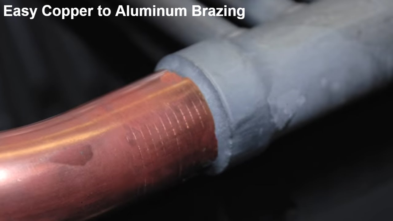

Example of Brazed Joint
Example of Brazed Joint Where Copper was Joined to Aluminum
