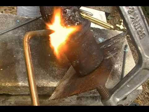

Often brazing is the best approach for repairing cast iron, particularly when the parts need to be rebuilt and then machined to the right tolerance.
If you want to braze cast iron, melting the base metal is not necessary since the rod has a built-in flux.
Clearance should be around .003 for maximum tensile and shear strength.
The rod takes extreme heat, above 1400 degrees to penetrate the pores of the metal.
The rod required to braze cast iron welds all cast iron, brass, nickel, copper, and more than 50 different kinds of steel, including stainless.
Open the pours around the area to be repaired, drill, and grind out a U shape in the metal, so it is no longer a hairline crack.
With an angle grinder, practice with cast iron by grinding a slot 1/16th to 1/8th of an inch into the metal. Use a brazing or cutting tip to bring the metal to 1400 degrees.
The metal will start to turn red at 600 degrees, but continue heating.
Test the rod on the metal 1/4 inch outside the bulk of the flame.
The rod has a flux core that will melt much lower than the rod, so if the rod itself will not melt, have patience.
When you are close to 1400 degrees, it will look like you’re going to burn a hole in the metal but do not worry.
Once you see the rod itself is melting, scratch the rod all around the area to be repaired.
The rod will melt and, with the help of the flux core, will fuse down into the metal.
When you pull the torch, it will be cherry red for about 20 seconds.
If you have followed the instructions explicitly and scratched the rod all around the area to be repaired thoroughly, you will have the strongest weld possible on that particular metal.
You may then grind, shape, polish and paint as desired.

Video of How To Braze a Cast Iron Exhaust Manifold
