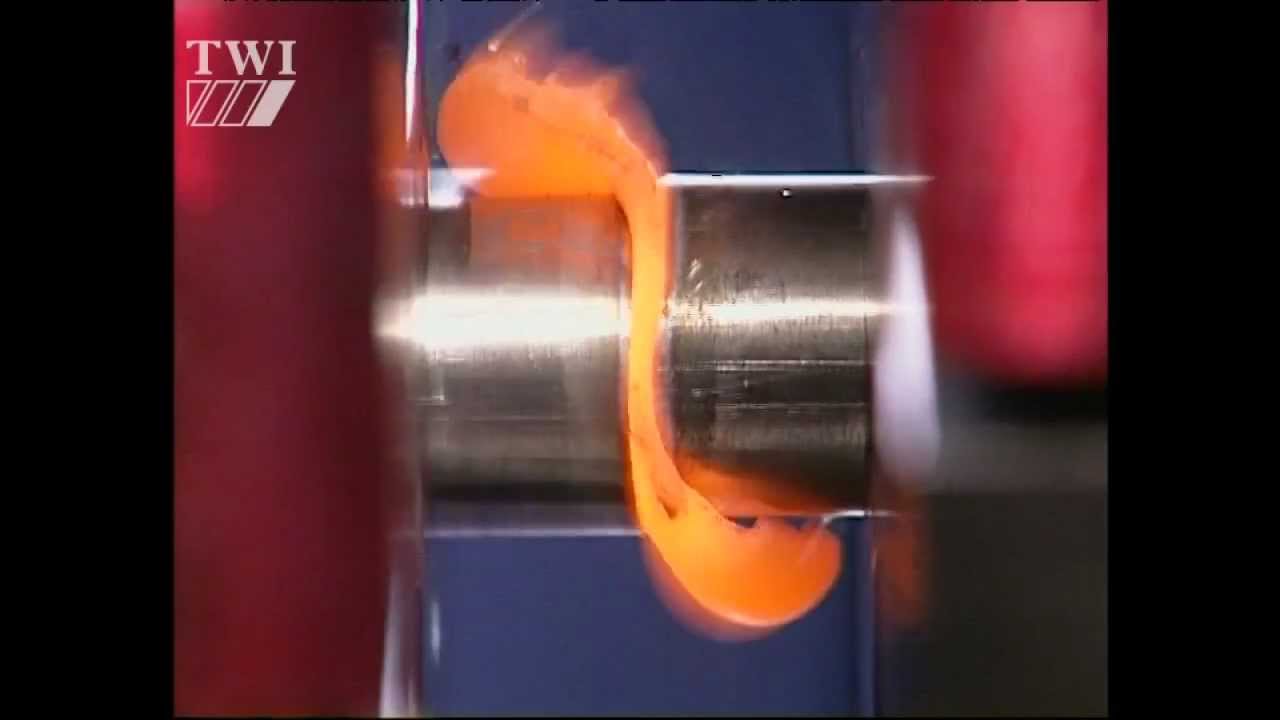

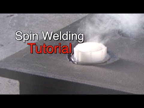

Spin welding involves a rotating chuck along with a flywheel. After reaching the required speed the motor disengages with the flywheel.
Linear Friction Welding
Linear Friction Welding Video
Linear friction welding
In linear friction welding, an oscillating chuck is used. It is applied to non-round shapes as compared to spin welding.  The material welded has to have high shear strength.
