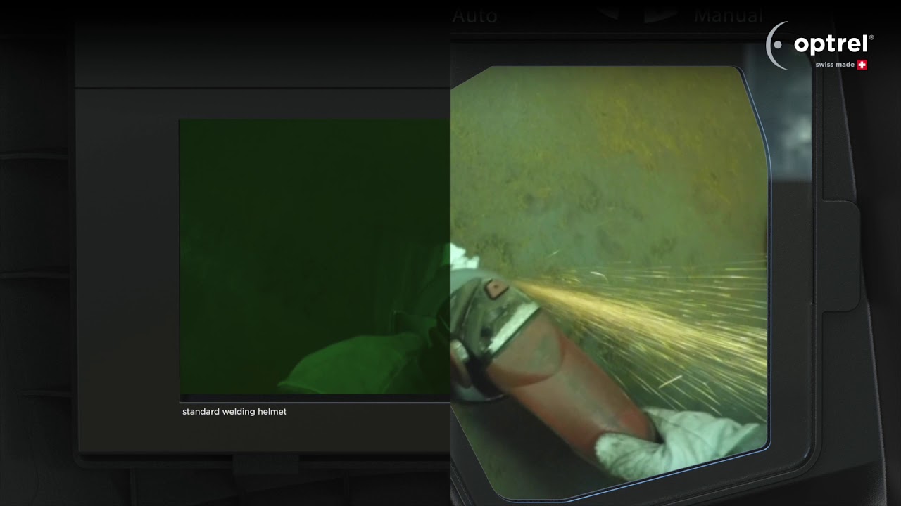

how grind mode works
Grind mode on a lens. Left view is a lighter shade to help see more easily.

When the grind mode is activated, the helmet is typically at shade #3. Although some helmets might have more shades (#5 to #8) to include plasma arc cutting, most will have the lighter shade, meaning you use grind mode exclusively for grinding or setups but never for welding.
After completing the grinding operation, you turn off the grinding mode without removing the helmet. Although these helmets may work automatically, physically switching the grind mode off ensures that you will be optimally protected as you return to welding.
See the short video below on the difference it makes to your view.
optrel Grind Mode
