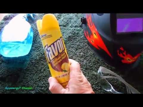

3. Use Polish
The last tip for cleaning your helmet is to use some polish, such as every day Pledge (furniture polish with wax) or Armor All (car polish and wax).
Even if you use glass cleaner first, topping that off with polish is still beneficial, as the polish also helps remove dirt. It also leaves a thin film behind, which will help prevent scratches.
Be sure to wipe off any swirl marks, which will ensure you do not have problems with light reflecting off the lens and making it harder to see while you are welding.
Polish will also help keep your lens from fogging up and smudging.
Finally, the polish fills in fine scratches, thus extending the life of your lens before you have to replace it.
