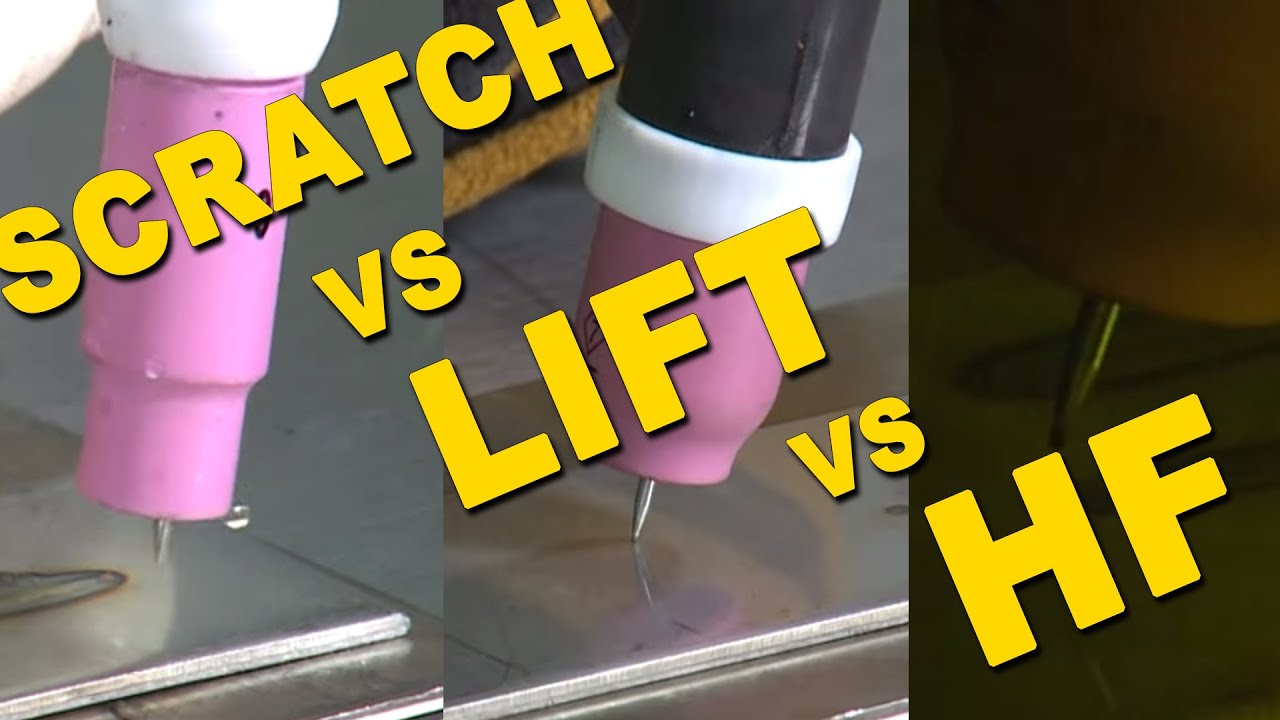

Video Comparing the Two TIG Start Methods
You can watch the YouTube video below to help you visualize the differences between the scratch start and lift TIG.
There are many videos on the internet, but this one plainly demonstrates the differences.
Plus, it compares the two arc starting methods with HF ignition to paint you a complete picture of your choices for TIG arc initiation.
Scratch Start VS. Lift Start VS. High Frequency Start | TIG Time
