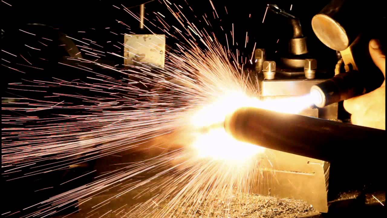

A quick example of Spray Welding
Flame Spray Welding
