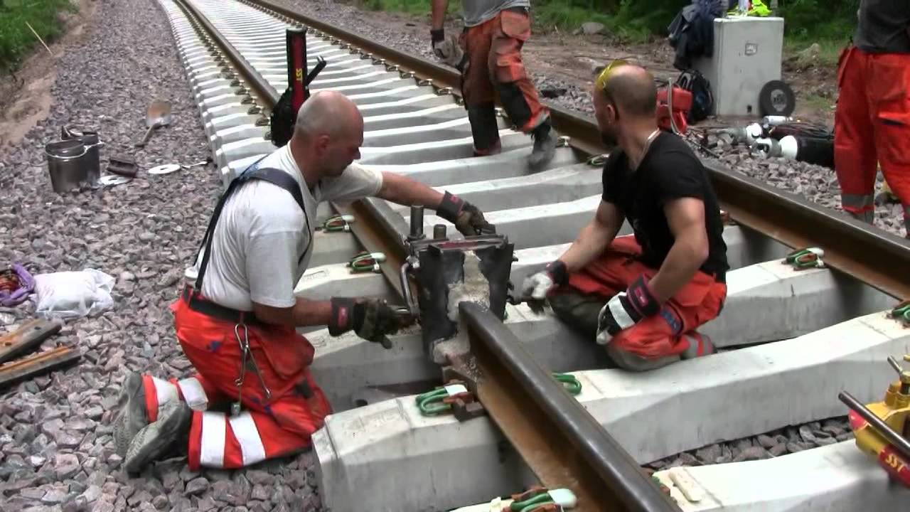

Welding Process for Rail: (see video above)
  1. Prepare rail to be welded
  2. Set the weld gap
  3. Clamp
  4. Apply molds
  5. Place Thermit portion into the crucible
  6. Preheat ends of the rails
  7. Ignite and pour steel
  8. Demolding
  9. Shear excess head metal
  10. Rough grinding
  11. Final grinding

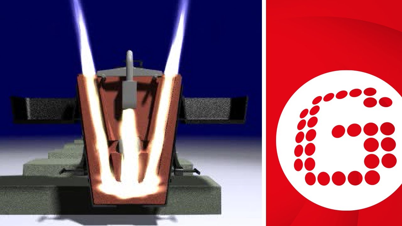

Thermit Welding Process Animation Video
Thermit Schweißung_Animation
