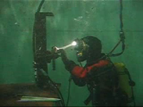

The two main categories of underwater welding techniques are:
  1. Wet underwater welding
  2. Dry underwater welding (also called Hyperbaric welding)
In wet underwater welding, shielded metal arc welding is commonly used, employing a waterproof electrode. Other processes that are used include flux-cored arc welding and friction welding.
In each of these cases, the welding power supply is connected to the welding equipment through cables and hoses.
The process is generally limited to low carbon equivalent steels, especially at greater depths, because of hydrogen-caused cracking.
In dry underwater welding, the weld is performed at the prevailing pressure in a chamber filled with a gas mixture sealed around the structure being welded.
For this process, gas tungsten arc welding is often used, and the resulting welds are generally of high integrity.
The applications of underwater welding are diverse – it is often used to repair and construct ships, offshore platforms, and pipelines. Steel is the most common material welded.
In terms of underwater cutting, oxygen-arc cutting with exothermic electrodes and steel tubular electrodes are also used.
Due to the danger and demands on the body, welders or cutters often work 1 month on and 3 months off.

Process
  • Use a pre-job meeting to do a job safety analysis. Get the crew together at the beginning of the job to review the hazards and plan. (use the Job Safety Analysis – JSA format)
  • Use an adequate size DC welding generator using straight polarity. Straight polarity is obtained by connecting the negative lug to the torch and the positive to the ground lead. Never use AC for burning or welding in the water. The electrical shock caused by AC current prevents voluntary relaxation of the muscles that control the hands. If electrocuted a diver may be unable to let go if his body or equipment accidentally enters the electrical circuit. If you use a rectifier machine, use a modern one that has up to date technology
  • Divers should wear insulated gloves at all times when burning or welding.
  • Attach the ground lead of the generator as close to the worksite as practical so that the diver is never between the electrode and the ground.
  • Make sure there is a positive operating disconnect switch on the torch side of the current. When the diver is changing burning rods or doing anything other than burning, the disconnect switch must be in the open position (as shown). It is important that the opening and closing of the switch be directed by the diver. Each command should be confirmed by the diver using the terminology “make it hot,” or “make it cold.”
  • Polarity can be checked by immersing the rod tip and ground clamp into a bucket of saltwater 2″ apart. Energize the rod by closing the safety knife switch. A stream of the bubble should rise from the rod tip. If not reverse the polarity and retest.
  • After the diver enters the water, the first task is to clean a spot for the ground clamp. The spot should be in a position in front of the diver, as close as practical to the weld joint and should be scraped or wire brushed shiny clean. For diver safety, only C-type clamps should be used as grounding clamps for underwater cutting or welding operations. The clamp must be firmly secured to the workpiece and the cable should have
    sufficient slack to prevent it from being pulled loose. The diver may elect to lightly tack weld the clamp in place when there is a possibility of it working loose. The ground should always be kept in the diver’s forward line of vision.
  • The diver should make a test weld to check the “heat” at working depth.
  • When the electrode has been consumed to within 3″ of the torch, stop the cut and signal to “make it cold.” before attempting to change electrodes. Maintain the torch in the cutting position until the tender acknowledges “make it cold” or “switch off.”
  • It is not safe to operate the welding torch without the flash arrestor in place.
  • Never speed up the cutting by creating a fire or inferno deep inside the metal. Such a situation can lead to an explosion.
  • Do not cut non-ferrous metals underwater since they do not oxidize and have to be melted. Cutting non-ferrous metals can result in an explosion.
  • Ignition should not occur underwater when the oxygen pressure is low. This will result in the cable to burn inside itself, possible blowing holes through the cable, a situation that can result in injury.
  • A diver risks electrical shock when welding or cutting when partially immersed in water.
  • Acetylene is very unstable at pressures above 15 psi and is not used for underwater cutting.
  • The hand should never be closer than 4″ from the electrode tip.
  • The diving tender should always maintain a written record of the following in order to repeat what worked during the next welding or cutting session:
    • The welding amperage as read from the tong meter.
    • Both open and closed-circuit voltage as read from the voltmeter.
    • Electrode diameter, type, manufacturer and waterproofing material.
    • Electrical polarity.
    • Length of welding cable.
    • Depth of work site.
