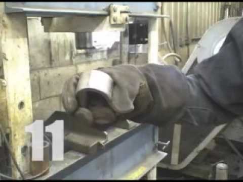

SMAW 4G Overhead Welding Certification Process
The video above describes a typical qualification test used in welding certification.
Please note that the welder’s part of this test starts when you see the number “2” in the lefthand corner of the screen. The test stops after Step “8”. The other steps you see are completed by the inspector, who removes the backing bar, marks the plates, cuts the coupons, and bends them to see if the weld is sound. (A coupon is an extracted slice of the welded metal.)
