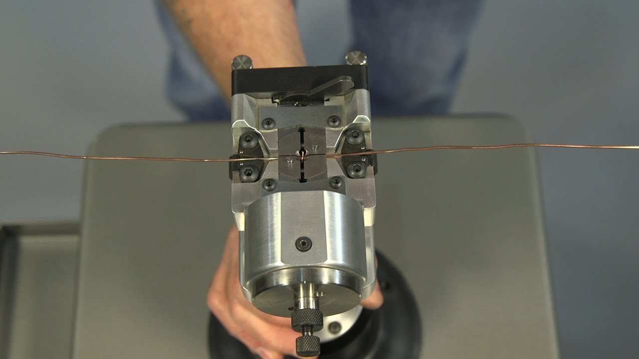

Cold Welding Machines For Joining Wires
handheld cold welding machine
Cold welding machines are hand-operated for small wire diameters. But larger diameters require a pneumatic or electric-pneumatic operation. Most of these machines are portable and can handle wires, rods, and strips.
Using an air hydraulic intensifier, a portable cold welding machine will generate extreme pressure. On the operator’s side, there is a “welding head.” It’s located on the top of the machine and serves to accept a welding die, offer stability, and control the applied pressure.
After the die is placed and secured into the die pocket, the wires/rods are fed in on the sides. Applying pressure causes the die to grip the wires near endpoints and push them together tightly. As a result, minuscule impurities that remained on wires’ cross-section surfaces are squeezed out from their cores outwards. That’s why cold welding wires create a better joint bond than welding sheet metal. This is only possible because wires have a small joining surface area, unlike sheet metal.
Pressure is applied a minimum of four times to eliminate all of the impurities. This process is called a “multi upset principle.” After the wires have bonded, you can remove them from the machine and chip away the residue around the joint area.
HP180 small cold welding machine for high quality welds on wire, strip and profile 0.30mm to 1.80mm

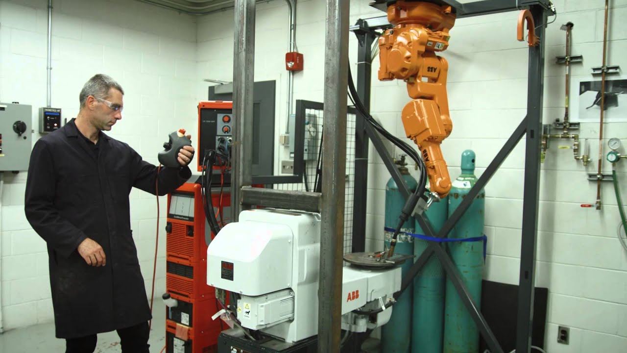

Cold Metal Transfer
Cold metal transfer (CMT) is a fusion welding process that uses a welding arc to create a joint. It’s often mislabeled as “cold welding,” causing confusion. CMT is a MIG welding process that requires about 90% less heat input than a regular MIG welding process.
Since this arc welding method is so “cold,” it solves many problems like the actual cold welding process. However, you shouldn’t mistake these two.
The CMT uses an electrical arc, filler metal wire, and we can use it with metals where cold pressure welding is not an option. But the CMT relies on precise filler wire retraction upon arc initiation to control the heat input.
It’s only possible for a robot to do this, and it’s not economical if cold pressure welding is an option.
