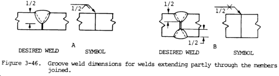

Depth of the Bevel
A weld bevel may not extend to the other side of the weld joint. In these cases, you’ll see dimensions to the left of the weld symbol. These numbers are the depth of preparation and depth of penetration.
The depth of preparation is the distance the weld prep extends down into the weld joint. The depth of penetration is how far the weld metal should extend into the weld joint.
The depth of penetration will be in brackets, separating it from the depth of preparation.
© weldguru.com – Image usage rights
In the example image above, we see a V groove weld symbol that indicates that the weld is on the other side of the weld joint and gets a ½” depth of preparation, and the weld needs to penetrate ⅝” into the weld joint.
This next example above illustrates how to prep a joint where there are different depths. In this case, the arrow side of the joint has a ¼” depth, while the other side has a ⅜” depth.
If no depth of preparation is listed, you’ll bevel the joint all the way through, or in the case of a symbol on both sides, to the middle to make a point.
