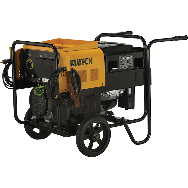

3. Klutch 6000K Arc Welder - Best Economical
  • Processes: DC Stick
  • AC Generator
  • Generator power: 6,000 watts
  • Fuel tank capacity: 5 gallons
  • Engine size: Kohler 429 cc
  • Welding power: 170 amps
  • Duty cycle: 30% @ 170 amps
  • Weight: 230 lbs.
  • New improved model uses new inverter technology
  • Inverter arc is a great improvement
  • Generator puts out enough continuous power to weld and run handheld power tools simultaneously
  • Powerful enough to stick weld up to 3/8 inch steel
  • Light enough to move around with included running gear
  • Economical, budget-friendly choice
  • Fuel tank provides up to 8 hours run time
  • Price includes a 3-year limited warranty
  • 30% @ 170 amps duty cycle will be to low for some users
  • Limited to DC stick welding process
  • Recoil pull start, no electric starter
The Klutch 6000K Arc Welder/Generator is a new update with inverter technology using a 429CC gas engine to spin the generator, putting out a respectable 6,000 watts of continuous power. That’s enough power to weld up to 3/8 inch steel and run your handheld power tools. This makes it an excellent alternative to the Hobart Champion 145, providing better value for money.
Engine-driven welders tend to weigh over 400 lbs., even the small ones. But the Klutch 6000K weighs just 230 lbs.
That makes this unit your choice if you do need to move the welder often as you work. Plus, the included running gear lets you roll the machine around like a wheelbarrow.
The negatives for some users are that the Klutch 6000K only welds using a DC stick process, and its duty cycle is 30% at the maximum amperage. But for those who need to do things like weld equipment out in the middle of nowhere, this is plenty to get those remote jobs done.
On the positive side, the Klutch 6000K can arc weld stainless and mild steel, hard surfacing, aluminum, and cast iron. This versatility to remotely weld various types of stock combined with an attractive price tag will appeal to many.
As a bonus, Klutch manufactured this affordable engine-driven welder rugged enough to handle the rigors of welding in unusual places. Plus, they back it with a  3-year limited warranty (2-year limited warranty on the engine).

Most welders/generators are heavy. That’s just a fact. So, they are usually mounted to trailers or truck beds to transport them.
But there are smaller ones like the Klutch 7500K Arc Welder/Generator that only weigh around 250 lbs. This is about the same as an average 5000-6000 watt generator.
Many 4000-watt engine-driven welders come with wheels and handlebars to make loading, unloading, and moving easier. But this wheelable unit gets you 6000 watts of continuous power and weighs in at a svelte 230 lbs.
