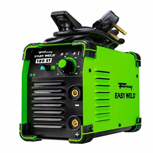

6. Forney 180 ST Stick Welder
- Lightweight at 14 pounds
- Highly portable
- DC stick and DC TIG
- 5-year warranty
- IGBT inverter power
- Dual purpose arc welder with TIG ability
- High frequency lift arc
- 10-180 amp current adjustment
- Includes regulator and accessory case
- Welds from 18-gauge sheet to 1/2-inch steel
- Can't connect a TIG foot pedal
- No gas regulator
The Forney Easy Weld 180 ST is a lightweight 14-pound dual-purpose stick welder. This is a DC arc welder with TIG capability included. It runs on 120 or 240 volts input, delivering 10 to 180 amps of DC current. It accommodates generator power, tolerant of “dirty power” frequency fluctuations that often make it hard for welders to work on standard generator power.
This is a powerful machine that can run single pass welds on 1/2-inch steel and at 10 amps lower limit, it also provides fine TIG quality on sheet metal as thin as 24 gauge steel. That’s fine enough to weld on auto-body sheet metal with a stick welder. If you want to use the TIG side of the machine, it doesn’t ship with a TIG torch or a gas regulator, so those items need to be purchased separately. This particular machine doesn’t accept a TIG foot control pedal.
The stick welding side gets great reviews for smooth and easy-starting arc welding. The Forney Easy Weld 180 ST maintains Forney’s high standards of industrial quality build and comes with a 5-year warranty.
