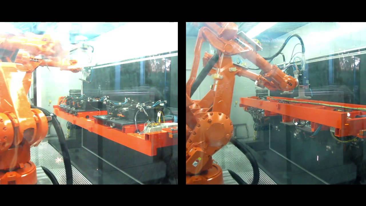

Robotic Welding and Cutting Examples Video Demonstration
ABB Robotics - Welding & Cutting - 10 Popular Examples
