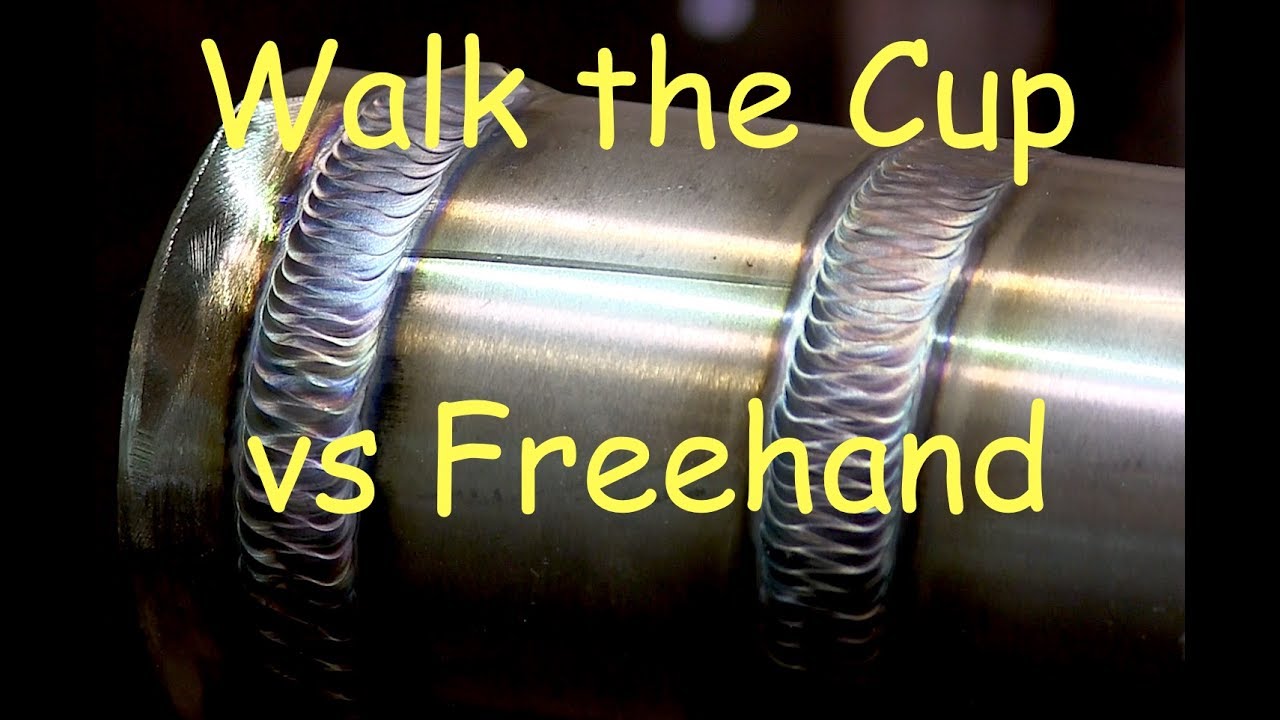

Walking The Cup (for TIG)
On a root pass for pipe, welders often use a TIG torch. It gives you a cleaner, more precise bead than you can get with stick or MIG welding.
Also, the process usually incorporates a specific hand stroke known as “walking the cup.” In this case, the cup is the ceramic insulator surrounding the tungsten tip. The welder simply rocks the cup back and forth along the weld joint.
It is easier to demonstrate, and the video below provides more detail on this technique:
