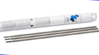

e6010-welding-electrodes
Popular Welding Rod (E6010) used for general purpose fabrication, construction, pipe welding, and shipbuilding

Stick Electrodes
Stick welding electrodes vary by:
  • Size: common rod sizes are 1⁄16, 5⁄64, 3⁄32 (most common), 1⁄8, 3⁄16, 7⁄32, 1⁄4, and 5⁄16 inches. Core wire used with electrodes needs to be narrower than the materials that are welded.
  • Material:  stick welding electrodes come in  cast iron, high carbon steel, mild steel, iron-free (nonferrous), and special alloys.)
  • Strength: referred to as tensile strength. Each weld needs to be stronger than the metal being welded. This means that the materials in the electrode need to be stronger as well.
  • Welding position (horizontal, flat, etc.): different electrodes are used for each welding position.
  • Iron powder mix (up to 60% in flux): iron powder in the flux increases the amount of molten metal available for the weld (heat turns the powder into steel).
  • Soft arc designation: for thinner metals or metals that don’t have a perfect fit or gap.
SMAW Welding Electrode Diagram
As described above, there are many kinds of electrodes. Here are the most popular stick welding (SMAW) electrodes:
  • E6013 and E6012: For thin metals and joints that do not easily fit together.
  • E6011: Good for working on surfaces that are oily, rusted, or has dirt. Versatile in that it works with DC or AC polarity. Creates little slag, another big plus. Note that this electrode should not be placed into an electrode oven.
  • E6010: Similar to the E6011 but only works with direct current (DC). Note that this electrode should not be placed into an electrode oven.
  • E76018 and E7016: Manufactured with iron powder in the flux. It creates strong welds but has a puddle that might present some control issues for beginners.
