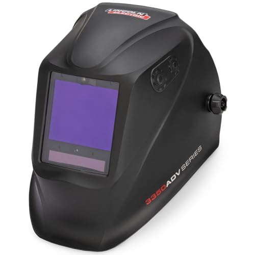

1. Lincoln Electric Viking 3350 ADV
Best Lincoln Welding Helmet Overall
WeldGuru Rating: 5/5
The Viking 3350 series is Lincoln’s best-selling welding helmet. The latest 5th-generation “ADV” adds more advanced features such as a Bluetooth mobile app that operates the digital controls and tracks maintenance needs and a modular work light that attaches to the helmet.
| Weight | 1.38 lbs |
| Price range | $$$$ |
| Viewing Area | 3.74 x 3.34 in – 11.8 in² |
| Side Windows? | No |
| No. of Arc Sensors | 4 |
| Optical Class | 1/1/1/1 Optical Clarity |
| Lens Reaction/Switch Time | 1/25,000 second |
| Shade Range | 5-13 |
| Grind Mode? | External, low profile |
| TIG Amp Rating | DC ≥ 2 AmpAC ≥ 2 Amp |
| Digital Screen? | Yes |
| Controls | Digital, with buttons |
| True Color? | Yes |
| Memory Settings | Yes |
| Hardhat Compatible | Yes |
| Replaceable Batteries? | Yes |
| Warranty | 5 Years |
The Lincoln Electric Viking 3350 ADV is a top-of-the-line professional helmet and is my go-to choice. The 3350 helmets have 12.5 square inches of 4C True Color viewport which make viewing your work easy, and include the lightweight X6 Headgear which is easy to adjust.
The light shell weight and the comfortably padded headgear combine with a big view, creating a legion of loyal fans. It’s well worth its price.
Lincoln recently released the 3350ADV (K3034-5), the 5th generation of this popular, best-selling, hard hat-compatible welding helmet.
A Bluetooth app, improved True Color optics, and an optional headlight are professional upgrades in the 3350ADV series that probably now best the Miller Digital Elite.
Related: Viking 3350 vs Miller Digital Elite
It’s not yet available in the usual wide variety of graphic styles, but the 4th gen 3350 helmets (K3034-4) are still available at a discount and are an outstanding choice.
- One of the best-selling helmets
- Thoroughly tested with a proven track record
- Excellent optical clarity
- External grind mode button for easy switching
- Comfortable and lightweight
- Big viewport with digital display
- Downloadable performance tracking
- Long-lasting batteries with up to 300 hours of use
- Excellent 3-year warranty
- A little bulky
- Expensive
- No side windows

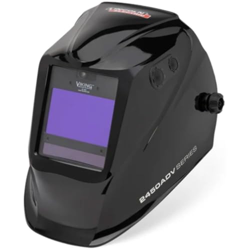

3. Lincoln Electric Viking 2450 ADV Series
Best Lightweight Lincoln Welding Helmet
WeldGuru Rating: 4.5/5
The Viking 2450 ADV is the lightest Lincoln helmet. Designed for those wanting to improve comfort, minimize fatigue and increase maneuverability. It’s the second best selling helmet after the 3350. The ADV is the latest upgrade to the 2450 series.
| Weight | 1.5 lbs |
| Viewing Area | 3.82×2.44 inches = 9.32 in² |
| Optical Class | 1/1/1/1 |
| Lens Reaction/Switch time | 1/25000 |
| Grind Mode? | External |
| TIG Amp Rating | 2 amps |
| Controls | Buttons |
| True Color? | Yes |
The Lincoln Electric Viking 2450 ADV is a premium, professional welding helmet designed for lightweight and comfortable workdays.
It’s perfect for DIYers, craftsmen/artists, and lighter-duty jobs instead of overhead welding on thick material. The shell is as thin and light as possible, so it isn’t intended for high heat or thick slag.
The Viking 2450ADV has the same 4C True Color auto-darkening lens, digital controls, and X6 padded adjustable headgear as the 3350ADV series.
It has a smaller viewing area than the Viking 3350ADV but is still a very large viewport at 9.3 square inches. Another difference from the 3350ADV is that this helmet doesn’t have a Bluetooth mobile app.
Like the 3350ADV and 3250D, the 2450ADV includes the adjustable LED modular work light with the external low-profile grind button.
Also like the 3350ADV, the 2450ADV isn’t available yet in the graphic choices in the rest of the 2450 series, but the older version still sells at a price savings over the 2450ADV. It has a wide choice of paint jobs and remains an excellent choice.
- Excellent auto response times and performance
- Lightweight Lincoln helmet
- The second largest lens size after the 3350
- ADV comes with a handy modular worklight
- 4C auto-darkening lens
- External on/off and grind mode buttons are super handy
- Narrower viewport than 3350
- Too lightly built for some jobs
- No Bluetooth app like 3350
- Expensive

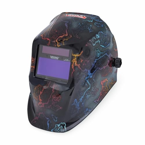

4. Lincoln Electric Viking 1840
Best Mid-Range Helmet
WeldGuru Rating: 4/5
The Lincoln 1840 is a mid-range helmet with a good balance of features, price, and comfort. It’s perfect for new welders and students. The Pivot Headgear isn’t as advanced as the adjustable X6 Headgear. However, the 1840 does have an external low-profile grind mode button, and it’s hard hat compatible.
| Weight | 1.25 lbs |
| Price Range | $$$ |
| Viewing Area | 7 in² |
| Lens Reaction/Switch time | 1/25000 seconds |
| Shade Range | 7-13 |
| TIG Amp Rating | 2-5 amps |
| True Color? | Yes |
| Memory Settings | Yes, No |
| Warranty | 5 years |
The Lincoln Electric VIKING 1840 is a mid-range welding helmet from Lincoln. It’s a good helmet when you must balance price with features—for instance, for students or entry-level welders.
It also features a 4C True Color auto-darkening lens, but it’s only 7 square inches compared to the 9.3 square inches found on the 2450ADV. However, that’s still a pretty wide viewing area.
The Lincoln 1840 helmet is hard hat compatible. This helmet uses the comfortable Pivot Headgear instead of the X6 Headgear found in the 2450ADV.
The low-profile external grind button and digital controls add to its overall value, but other brands have competing choices at this price point.
At 1.25 pounds, the Viking 1840 is surprisingly light for the cost, even lighter than many helmets that cost much more.
- Great value
- Comfortable fit
- Lightweight
- Headgear isn’t the X6
- No Bluetooth app
- Smaller viewing area than 2450ADV
