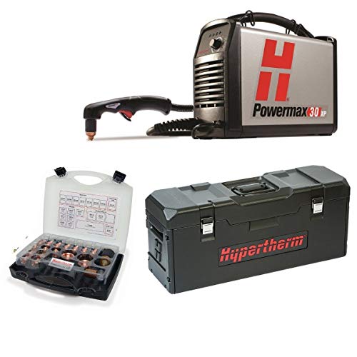

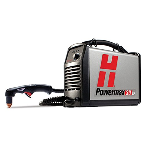

1. Hypertherm Powermax30 XP
Best Plasma Cutter Overall
WeldGuru Rating: 4.5/5
The Hypertherm Powermax30 XP is a great all-around machine for anyone who needs a portable but powerful plasma cutter. This machine is versatile enough to use in a home shop and in a large-scale fabrication shop.
  • Lightweight, making it easy to transport
  • One knob control means adjusting the machine is straightforward and easy
  • Dual voltage gives you lots of power and versatility
  • FineCut technology makes cutting thin materials accurate and easy
  • 30 amps of output can pierce ⅝” steel
  • Delivers the rated output, making cuts on ½” thick steel easy
  • The torch and ground clamp are good quality, giving years of service
  • No digital display makes knowing the exact amperage impossible
  • Multiple styles of consumables can be confusing
Input Voltage/s120/240V
Cutting Current15 – 25 Amps 120V15 – 30 Amps 240V
Max Clean Cut Thickness½” Thick Steel
Max Severance Thickness⅝” Thick Steel
Duty Cycle35% at 240V 20% at 120V
Arc Start Type Blowback
PilotArc?No
Screen Type None
Control Type Dials
Built-in Air Compressor?No
2T/4T?No
CNC Compatible?No
Machine Weight21 lbs
Warranty3 years
Price Range $$$$
hypertherm powermax 30xp demo
Testing the Hypertherm Powermax 30XP
If you’re looking for the gold standard of plasma cutters, look no further than Hypertherm. While they have many models, the Hypertherm Powermax30 XP is the one I’ve used the most and stands out for its quality-to-price ratio, which will appeal to most people.
It’s a USA-made machine that continues to serve the fabrication community. There’s a reason that Hypertherm has become a trusted name, and the Powermax30 XP performs well regardless of your skill level. This lightweight machine has 30 amps of cutting current, which will sever ⅝” steel plates but produce nice cuts on ½” plates.
If you need nice cuts on ⅝” plates and have the extra budget, I would go with the Powermax 45 as an upgraded choice. Also, if you don’t own a compressor, you can opt for the more expensive Hypertherm Powermax 30 AIR model with a built-in compressor.
The dial on the control panel has color-coded areas telling you the required input power and amperage. This feature makes it easy to know the machine’s capabilities at each voltage and amperage. Unlike less expensive machines I’ve tested, the Powermax 30XP delivers a full 30 amps of power. When you set the knob to 30 amps, you consistently get the full 30 amps of cutting power, giving you one of the smoothest cutting experiences.
My only issue with this machine is that three different sets of consumables are available. Each consumable has a specific voltage and purpose; mixing some components up would be easy.
Overall, I strongly believe the Powermax30 XP is a professional-grade plasma cutter with an approachable price point.

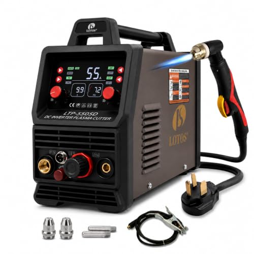

2. Lotos LTP5000D Plasma Cutter
Best Plasma Cutter For Home Use
WeldGuru Rating: 4/5
The LTP5000D delivers decent power in a small, affordable package that any homeowner can add to their garage shop. If you need a plasma cutter for the occasional project and don’t want to spend a lot of money, the LTP5000D is a good choice.
  • Dual voltage means this machine is both powerful and versatile
  • The digital display shows amperage
  • 50 amps of cutting current will sever ¾” thick plates
  • Pilot arc allows for no-touch arc starting
  • A built-in pressure gauge on the control panel makes keeping track of the pressure easy
  • High duty cycle means you can make longer cuts
  • Affordable for the homeowner who needs a good plasma cutter
  • Portable enough to take almost anywhere
  • Uses proprietary consumables, which means you can’t use third-party consumables
  • The ground cable is short, which makes working on larger projects difficult
  • Doesn’t deliver exactly 50 amp output and struggles to cut ½” plates
  • The torch and ground clamp are low quality, so they won’t put up with much abuse
Cutting Current10-50 Amps @ 240 V10-35 Amps @ 120 V
Max Clean Cut Thickness½” @ 240V5/16” @ 120V
Max Severance Thickness¾”
Duty Cycle60% at 120/240 V
Arc Start Type PilotArc
PilotArc?Yes
Screen Type Digital Display
Control Type Dials
2T/4T?No
CNC Compatible?No
Machine Weight27 lbs
Warranty3 years
Price Range $
lotos ltp5000d plasma cutter demo
Testing the Lotos LTP5000D
The Lotos LTP5000D is one of the most popular home plasma cutters on the market, and rightly so. For the price, it provides excellent value. It’s dual voltage and rated to deliver 50 amps of cutting current, enough to sever ¾” thick steel. If you need more power, consider the LPT5500D, an upgraded version of the LPT5000D.
The LTP5000D has a pilot arc, which allows you to start the arc without touching the base metal. This is an attractive feature found on higher-end machines; seeing this on an affordable machine like the LTP5000D is a bonus (full LTP500D review here).
The included torch has no third-party alternatives, so you’ll buy your consumables through Lotos. Also, the torch and ground clamp aren’t high quality, so they can’t take much abuse before breaking. This isn’t a big deal for homeowners, but you might want to look toward the higher-end machines for a shop environment.
The build quality isn’t up to the standards of Hypertherm or Miller, but it’s decent for machines at this price point. Also, these cheaper machines often don’t deliver the rated output, and the LTP5000D is no expectation. It claims a 50 amp output but doesn’t cut ½” plates as well as the Hypertherm Powermax30 XP, which delivers a full 30 amps of output.

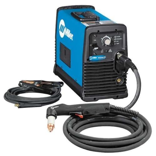

7. Miller Electric Spectrum 875 Plasma Cutter
Best Professional Plasma Cutter
The Miller Electric Spectrum 875 is a professional-grade machine with a price point that matches its build quality. While it’s out of reach for the average homeowner, for a fabrication shop that needs a high-quality machine, you can’t go wrong with the Spectrum 875.
  • Gives a full 60 amps of output, enough to sever 1.25” thick steel
  • Excellent cut quality
  • High amperage means you can cut thinner materials faster
  • Dual voltage gives good versatility in where you can use the machine in the shop
  • CNC ready, so connecting to a plasma table is seamless
  • Excellent build quality will guarantee many years of service
  • 20-foot torch cable makes working on large projects easy
  • Many advanced features like Auto-Refire, Wind Tunnel, and Fan on Demand justify the high price point
  • Very expensive, making this out of reach of the homeowner or hobbyist
  • Not able to run off 120 volts, making it not appropriate for most homeowners
Input Voltage/s208/230V
Cutting Current60 Amps
Max Clean Cut Thickness⅞”
Max Severance Thickness1.25”
Duty Cycle40% @ 208V, 50% @ 230V
Arc Start Type Blow Back
PilotArc?Yes
Screen Type None
Control Type Dials
2T/4T?No
CNC Compatible?Yes
Machine Weight49 lbs
Warranty3 years
Price Range $$$$$
The Miller Electric Spectrum 875 Plasma Cutter is the most expensive cutter on this list, but you get what you pay for. This cutter works better in high-production environments such as fabrication shops.
The input voltages also put this plasma cutter in a category outside the realm of DIYers, hobbyists, or homeowners. The Spectrum 875 runs on 208 and 230 volts and has an input amperage of 42 amps. This means this machine won’t interface with the electrical system of the average single-family home.
However, this is a fantastic machine if you’re running a small shop or have a shop on your property with the appropriate electrical service. The 60 amps of output will sever 1.25” thick steel, providing clean cuts on steel up to ⅞” steel. The torch consumables are common and widely available, and the torch itself has a 20-foot cable that’ll reach almost anywhere you want.
