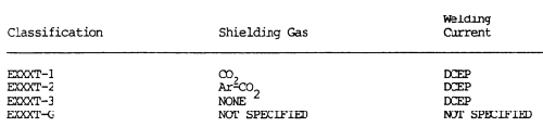

The AWS classification destinations for FCAW wire show whether a wire is self-shielding. The following numbers are for self-shielding wire:
- T-3
- T-4
- T-6
- T-7
- T-8
- T-10
- T-11
- T-13
- T-14
This process is ideal for outdoor applications because the shielding made by the flux is resistant to wind.
Dedicated self-shielding FCAW machines are often smaller, which a welder will carry around the job site. The portability of this process makes it ideal for situations that make access difficult.

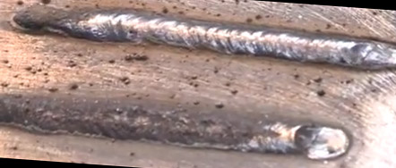

The flux in self-shielding flux-core wire will form a slag layer on top of the weld. The slag protects the weld metal as it cools, protecting it from the atmosphere and shaping the weld bead.
Self-shielding flux core costs less than gas-shielded flux core and is a good choice for outdoor welding or areas with difficult access, as no gas cylinder is necessary.
Gas-Shielded Flux-Core Welding (FCAW-G)
© weldguru.com – Image usage rights
Gas-shielded flux core (FCAW-G) needs to use an external shielding gas because the flux at the center of the wire doesn’t provide enough shielding gas to protect the weld from atmospheric gases.
Gas-shielded flux-core must use a welding gun that allows gas to flow through a regulator and a shielding gas cylinder. A gas-shielded welding machine will also be less portable than a self-shielding machine and limited to indoor use.
The AWS classification destinations for FCAW wire also show if a wire is gas-shielded. The following numbers are for gas-shielded wire:
- T-1
- T-2
- T-5
- T-9
- T-12
The same classification will also show what shielding gas to use:
- M = 75-80% argon shielding gas mix
- C = 100% CO2
The welds produced by gas-shielded flux core are higher quality than self-sheilding welds. They have less splatter, more penetration, and are more visually appealing. The slag on gas-shielded flux core welds is also easier to remove.
