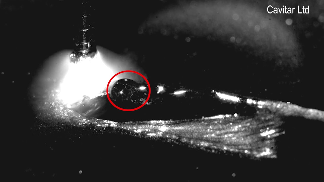

What is Slag Inclusion?
Slag inclusion example
© weldguru.com – Image usage rights
Slag Inclusions are a common welding defect that occurs when slag, a welding by-product, gets stuck inside the weldment. This is an unfavorable condition that creates performance issues down the line.
In most cases, it is a result of bad welding technique or improper selection of components and parameters.
This defect primarily occurs in flux-based welding techniques like stick welding and flux-cored arc welding.

Here’s a short clip of how slag inclusion happens with the cold metal transfer process:
YouTube video
