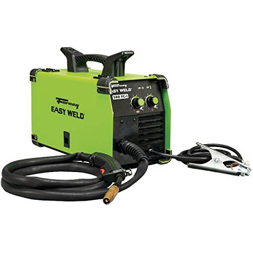

4. Forney Easy Weld 140 FC-i MIG 110v Welder
- Flux core only
- Weighs only 19 pounds
- All metal wire drive
- Infinitely adjustable settings
- 10-140 amps
- A flux core classic
- Generator friendly
- 32 gauge sheet to 1/4-inch plate
- Excellent value for money
- Takes both 4 inch and 8 inch spools
- Tweco-style MIG torch with easy find consumables
- Not gas-capable
- Short connections only 8 feet long
This machine is an inexpensive yet highly capable machine that represents great value. The Forney Easy Weld 140 FC-i is a versatile flux core-only box with a wide output range. I’ve recommended this machine to many new welders who want to pick up welding without gas.
Although it’s not gas MIG capable, this machine gets you 140 amps of wire-feed flux core welding right away. It’s worth considering the fact that the flux core process is better than MIG for outdoor welding when it comes to breeze resistance.
The Forney Easy Weld 261 MIG Welder will weld the thinnest sheet metal of any machine in this roundup at 32 gauge thickness, making it excellent for auto body and ductwork. At the other end of the power range, 140 amps will weld 1/4-inch plate steel. It can mount both 4 inch and 8-inch wire spools, however, one drawback is this is a cheap gasless welder, so the wire drive is made from all plastic (full review here).
The power level control on the Forney Easy Weld 140 FC-i MIG Welder is infinitely adjustable within its range from 10 to 140 amps. It comes with 10-foot MIG torch and grounding clamp. The speed adjustment for the wire feed is also infinitely adjustable.
