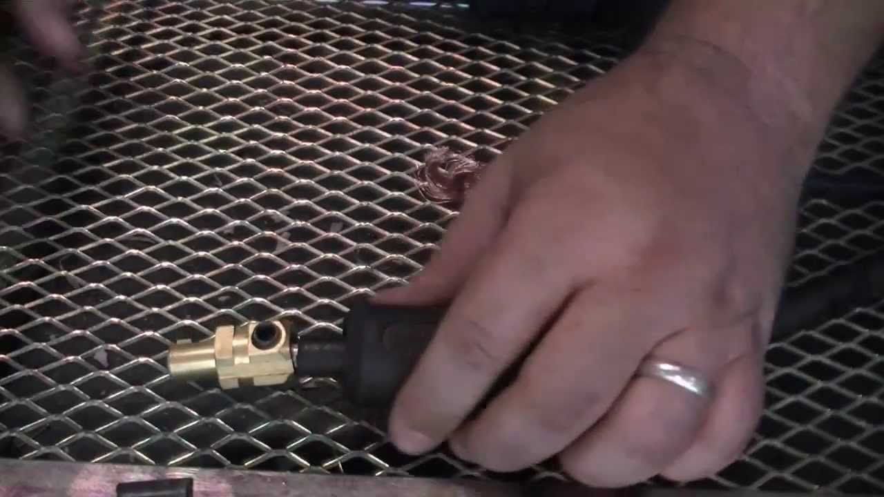

There are two ways to use this adapter:
  • Option 1: You have a single line TIG torch (gas and power go in one cable)
    1. Thread the torch connector to the brass power block and thread the power block to a separate gas line attached to your gas cylinder. The connection order is gas cylinder – gas hose – power block – single line TIG torch.
    2. Next, attach the stick electrode holder to the lug of the brass power block to provide power to the TIG torch.
    3. Be sure you switch your stick welder to DCEN output. If the stick welder is pre-set to work with DCEP, you won’t get the best performance.
  • Option 2: You have a two-line TIG torch (one line for gas and another for power)
    1. Connect the torch gas line directly to the argon regulator on the gas cylinder.
    2. Thread the power cable to the brass power block.
    3. Attach the stick electrode holder to the lug on the power block to power the torch.

If you must use the power block described above, don’t buy a TIG torch with a DINSE connector. There aren’t any power blocks available that support DINSE plugs.
Instead, get an air-cooled torch with a 3/8-24 RH fitting. But, some DINSE plugs use the power cable threaded into a 3/8-24 RH fitting on the inside.
So, even if you have a DINSE plug TIG torch, you may still be able to use a power block by disassembling the DINSE connector and then threading the 3/8-24 RH fitting to the power block.
