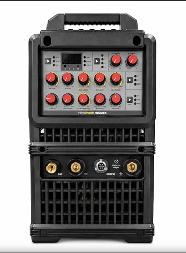

7. PRIMEWELD TIG225X - Tig/Stick Welder
- AC and DC TIG and stick welder
- Powered by IGBT inverter
- 3 year warranty
- Gas regulator included
- Wide output range 10 to 225 amps
- Pulse Width Modulation
- High frequency arc starts
- AC and pulse frequency 200 hertz
- CK-17 torch made in USA
- Metal foot pedal included
- Reports of inconsistent quality
- Manual is completely illegible
The Primeweld TIG225X is a versatile, full-featured AC/DC TIG welder with an awful lot of features for its price range. Pulse width modulation and AC phase adjustment provide the ability to modify bead width and depth characteristics. The AC waveform function cleans the weld puddle, removing impurities to eliminate bead cleaning chores.
This welder features a 100 percent duty cycle at 108 amps. This means you can weld continuously on 1/8-inch steel plate. Some owners report inconsistent build quality, with some machines arriving without wires hooked up and missing accessories. At the full 225 amps The Primeweld TIG225X has a 40 percent duty rating, meaning you can weld at max power for four minutes on 1/2-inch steel plate.
The Primeweld TIG225X gives the homeowner the same power as professional fabrication shops. This machine has a 3 year warranty. It ships with a metal foot control, a regulator and a CK17 torch with flex lines. With dual 120 volt and 240 volt input, huge adjustability and a very wide ouput range, the Primeweld Tig225X costs more than others in this roundup, but it’s well worth considering.
