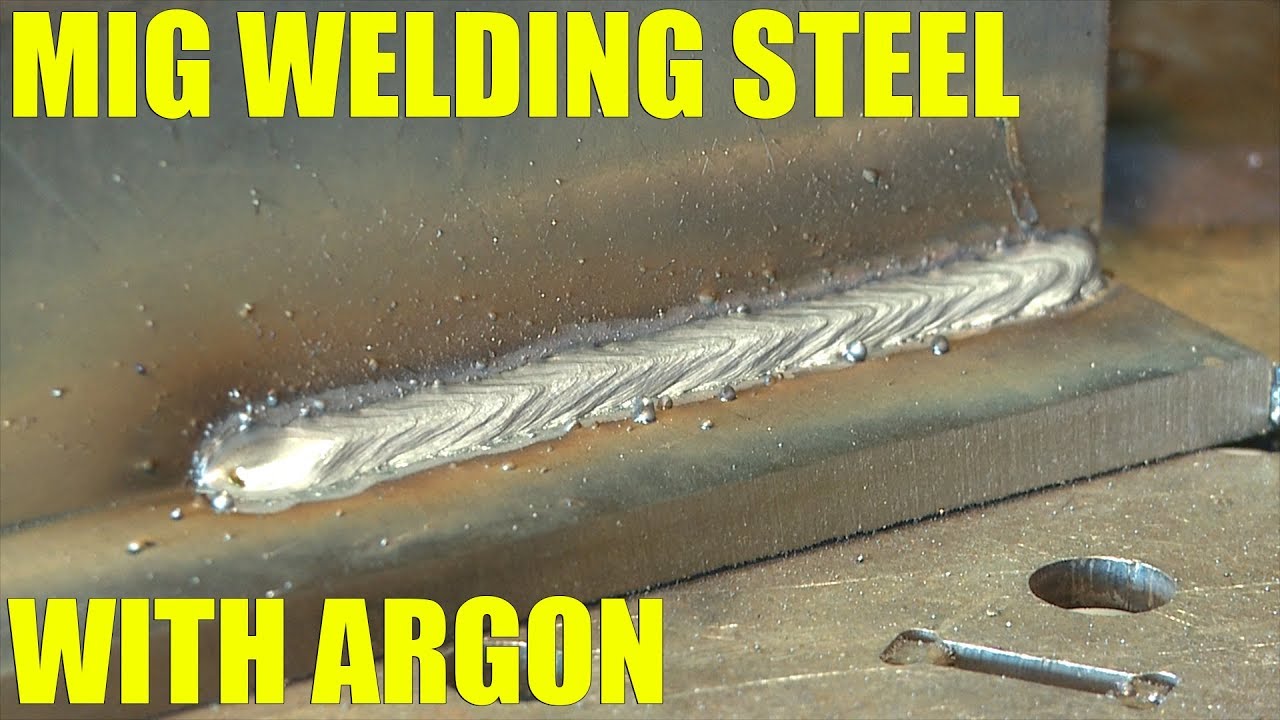

Some of the characteristics you will experience when using it include:
- Argon has a lower ionization potential, which reduces the arc voltage and power.
- The arc tends to be less stable.
- Combining an unstable arc with reduced power prevents the formation of a fluid, workable puddle. In other words, the molten pool will be of higher viscosity and harder to manipulate and control.
- Argon has lower thermal conduction, and the outer edges of the arc remain cool. This means you get narrow, reduced penetration with less fusion.
- The filler material sits on top of the steel in a narrow, tall bead.
- MIG welds using pure Argon are prone to undercutting.
- Experience shows that MIG welds on steel with pure Argon gas lose ductility. As a result, bending or twisting can crack or break the rigid weld.
© weldguru.com – Image usage rights
In summary, it is possible to weld steel together using a good MIG welder with 100% Argon shielding gas. But you end up with a shoddy-looking, weak, brittle weld that is not structurally safe.
If you need a strong, quality weld, 100% Argon is NOT a good choice for MIG welding steel.
These problems are even more pronounced with stainless steel, and using pure Argon to MIG weld stainless is never recommended.

If you find yourself in the unenviable position of having to MIG weld steel with pure Argon shielding gas, there are a couple of tips that may help.
- Bevel the edges of the joint. It will help fuse the base metal and make for a stronger welded joint.
- Turn up the heat, but be careful not to burn through thinner steel. Getting the bead to sit flat will likely be hard or impossible.
