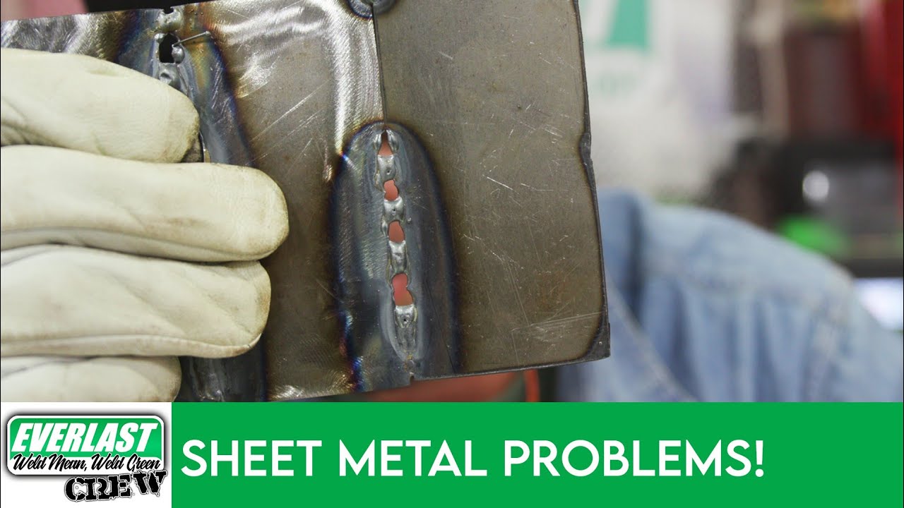

Burn throughs
Everything we discussed to avoid warping applies to preventing burn through.
If you blow holes in the metal, you’ve gone further in the wrong direction. Some excessive heat warps the metal sheet, but too much burns it away.
weld burn through example2
Examples of burn through
© weldguru.com – Image usage rights
So, increase your welding speed and place short, intermittent welds. Try to weld the joint from multiple positions. For example, divide the joint’s length by four, mark the divisions, and fuse each separately.
Use a shop air compressor to cool the sheet metal between welds. This choice is also helpful in preventing warpage, but if the material is too thin and you keep blowing holes through it, you’ll need all the help you can get.
Significantly lower the amperage output. If your current amperage setting burns through the metal, try dropping it 30-50%. Also, reduce the tungsten, stick electrode, or MIG wire diameter to the lower amperage accordingly.

Summary Video
This video by Everlast demonstrates many concepts we’ve discussed in this article. So, it can help you visualize what blow-through and warping look like and how to prevent them.
